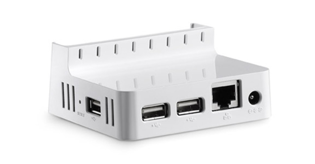

Seagate Dockstar
CPU ARM 1.2 Ghz
Memory 128 MB Ram
Installation:
The driver will be installed in memory for now, so far we also tested 2 DVB-C sticks at the same time.

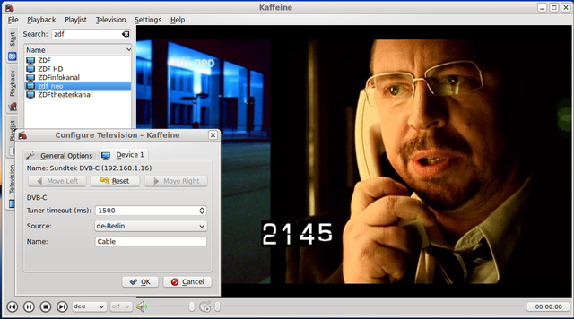

after this intallation you can simply follow the normal network clientsetup on remote pcs
Using DVB in your homenetwork
