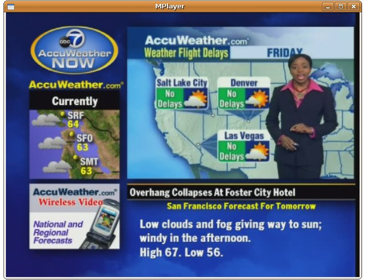

For using the device with mplayer:
$ mplayer tv:// -tv driver=v4l2:device=/dev/video1
MPlayer SVN-r29305-4.3.2 (C) 2000-2009 MPlayer Team
Playing tv://.
TV file format detected.
Selected driver: v4l2
 name: Video 4 Linux 2 input
 author: Martin Olschewski <olschewski@zpr.uni-koeln.de>
 comment: first try, more to come ;-)
Selected device: Sundtek MediaTV
 Tuner cap: STEREO
 Tuner rxs:
 Capabilites:  video capture  VBI capture device  tuner  audio  read/write  streaming
 supported norms: 0 = NTSC-M;
 inputs: 0 = Television; 1 = Composite; 2 = S-Video;
 Current input: 0
 Current format: YUYV
The driver automatically tries to figure out the correct audio playback.

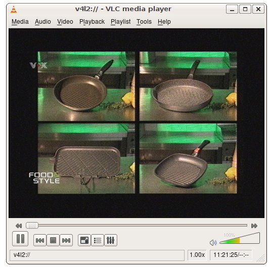

For using analogue TV with vlc, just start up VLC and select the corresponding capturedevice eg. /dev/video1 in our case
