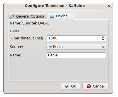

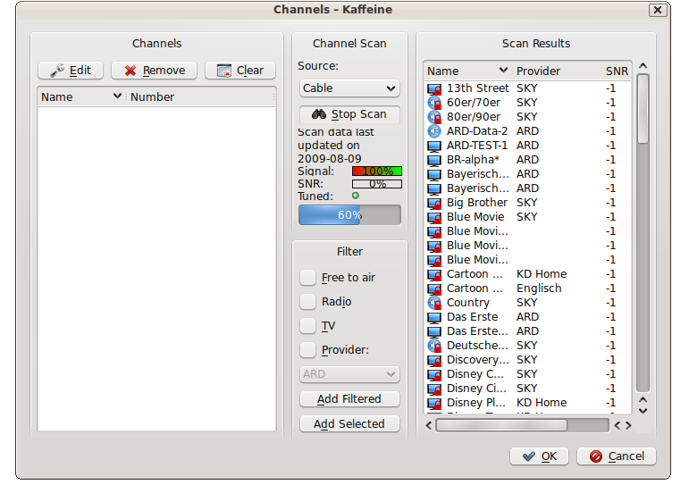

« Antwort #1 am: März 09, 2010, 04:02:47 Nachmittag »
With this driver I still have problems to use kaffeine (I already posted about it in a response to the driver version from February 11). As soon as I try to watch Digital TV (DVB-C) or press the button to scan for channels, kaffeine hangs and does not react any more until I kill it. With the driver version from January 25 everything works just fine.
I am using Ubuntu 09.10 with kaffeine version 1.0~pre3-0ubuntu1~karmic1~ppa1. The strange thing is that me-tv and gmplayer are working fine with the new version. However, these two are not nearly as comfortable as kaffeine.
I'm a bit frustrated as I bought the rather expensive sundtek stick because of its good linux support and now it is again a permanent hassle.

« Antwort #3 am: März 31, 2010, 10:31:18 Vormittag »
It turned out to be a problem with the new kaffeine version.
I am using kubuntu but I have the newest version of kde installed from "ppa:kubuntu-ppa/backports". With the kaffeine version 1.0~pre2-0ubuntu1 from the standard kubuntu repository everything works fine. As soon as I install the newer version 1.0~pre3-0ubuntu1~karmic1~ppa1 kaffeine hangs if I want to watch TV as described above. I am not sure if this is a general problem of the newer kaffeine version or just of this package. I apologize for my frustrated comments above. It is my fault if I am using bleeding edge software. Thanks for your help.
