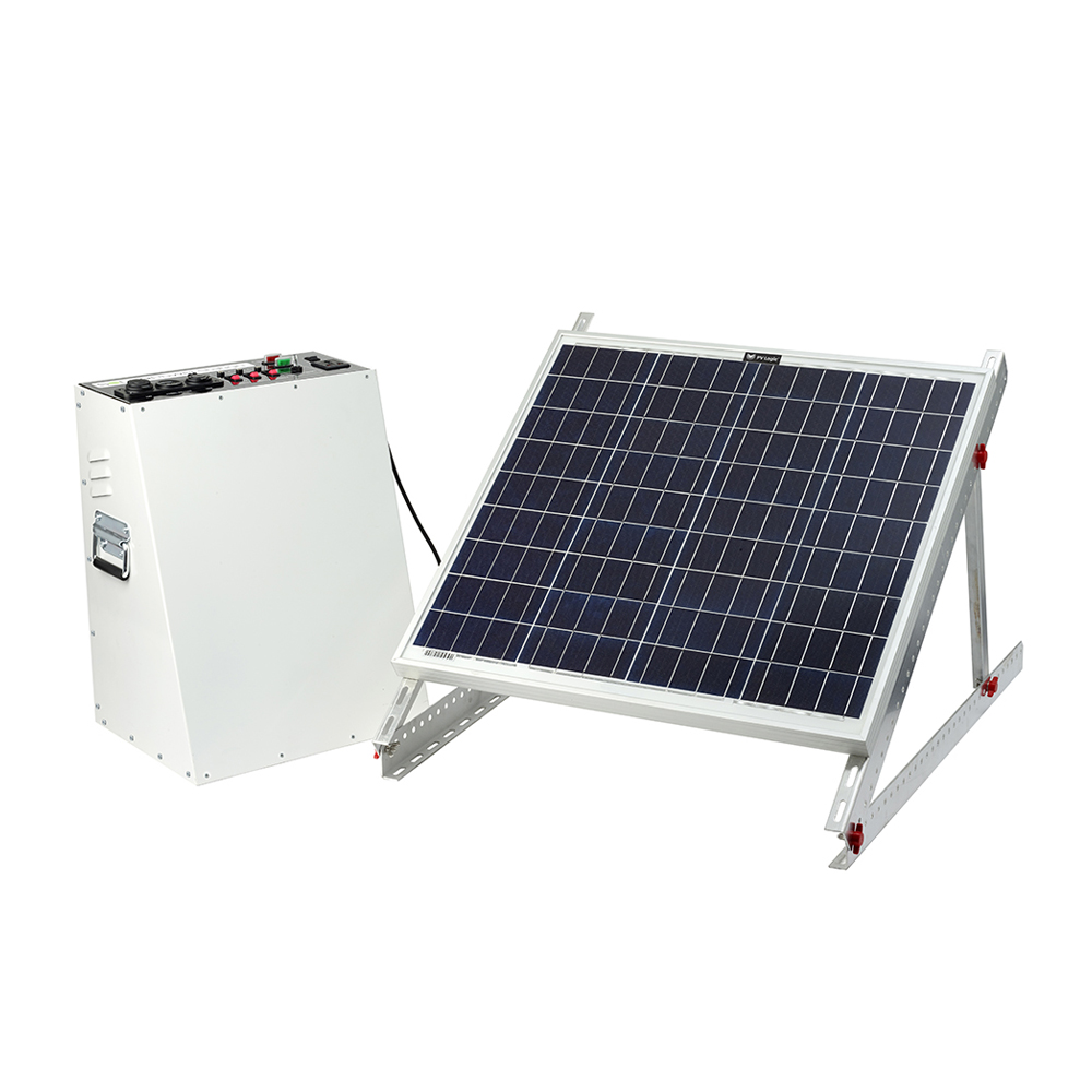

Transportable solar power system shows the way
Electrical independence is now a reality thanks to the all-new Hubi Power Station. This mobile energy system is the ideal means to provide power in a whole range of applications such as garden offices and hobby rooms, remote cottages and glamping chalets, site offices, field HQs, workshops, large stable blocks and agricultural buildings.
