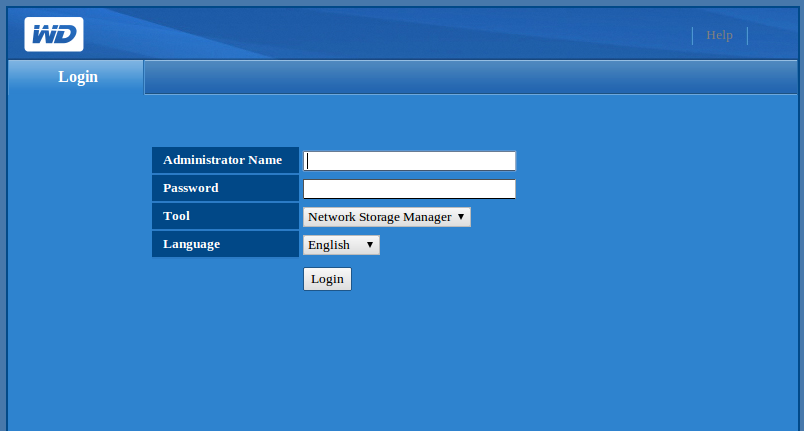

1. Login: (Login: admin password: admin or 123456)

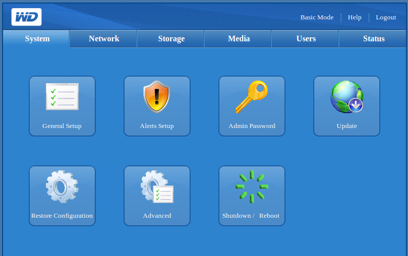

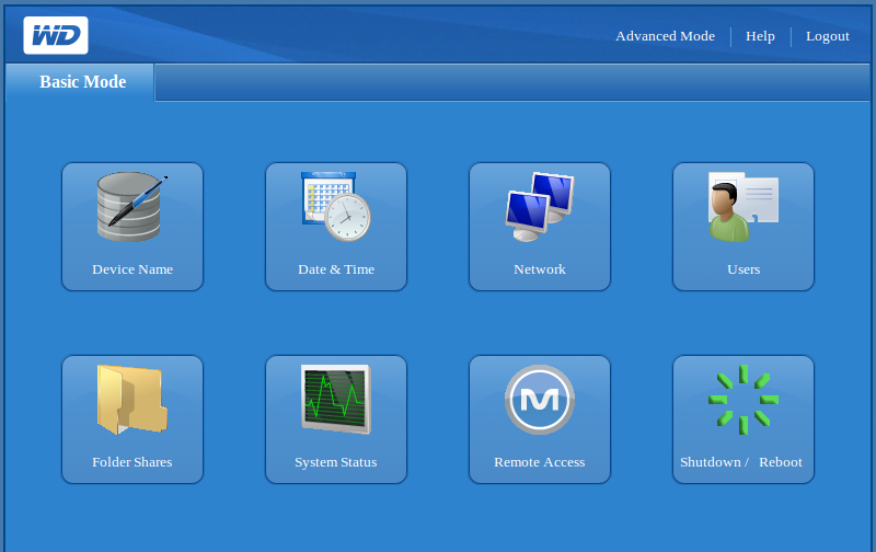

2. choose advanced mode
3. choose advanced:

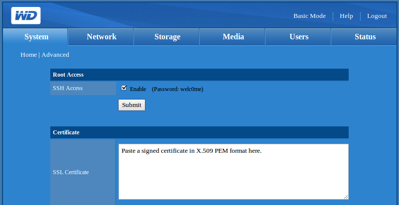

4. SSH Access Enable
5. login into the NAS:

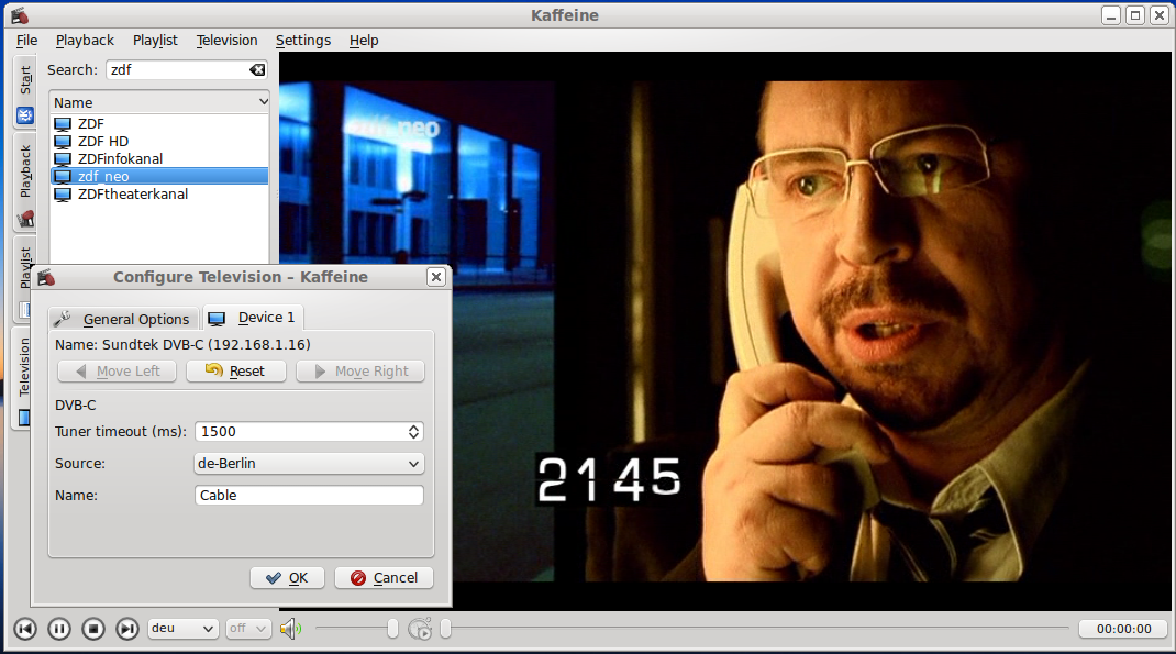

on a linux workstation you can now load the remote TV tuner and use it as local device:
$ /opt/bin/mediaclient --scan-network
Scanning network for IPTV media servers
 IP address       | ID  |  devicename          | Users | Capabilities
 192.168.1.16     | 0   | Sundtek MediaTV Pro  | 2     | DVB-T, DVB-C
 192.168.1.4      | 0   | Sundtek MediaTV Pro  | 2     | DVB-T, DVB-C
-  2 IPTV server found ----------------------------------------------
$ /opt/bin/mediaclient --mount 192.168.1.16
