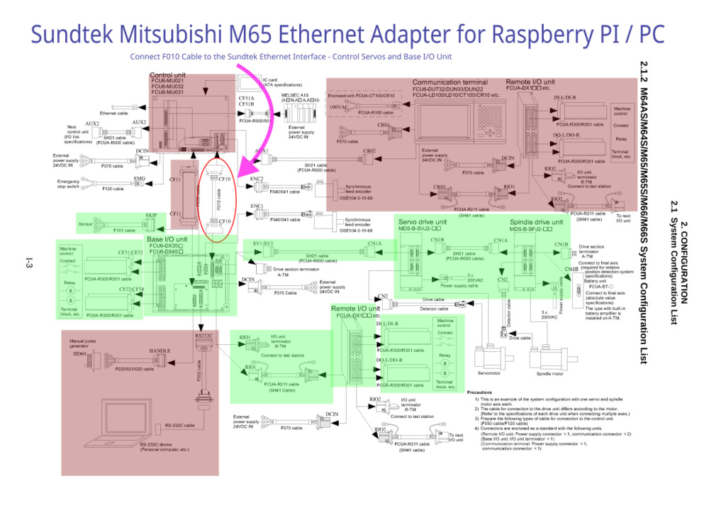

We’re currently putting the final touches on our Mitsubishi M65 Ethernet Bridge, designed for Raspberry Pi, PC, and similar systems.
The bridge provides full support for MDS-B-SVJ2 / MDS-B-SPJ2 servo drives as well as the original Mitsubishi I/O boards, enabling seamless integration of 25-year-old Meldas M6x control systems into LinuxCNC.
While the original hardware is still very capable—especially the servo drives—the spindle performance (typically around 8000 RPM) can benefit significantly from modern control. With LinuxCNC, you gain improved motion planning and look-ahead, resulting in noticeably better overall machine performance.
Also the system won't require a battery anymore, and it's not required to set up any options since LinuxCNC is unrestricted and fully open.
You lost the toolchanger Macro or other settings and cannot get them back? No problem it can be easily configured again.
Our initial target system is a 3 Axis Manford VMC1100 (7 tons) CNC
https://manford.com.tw/product/detail/164

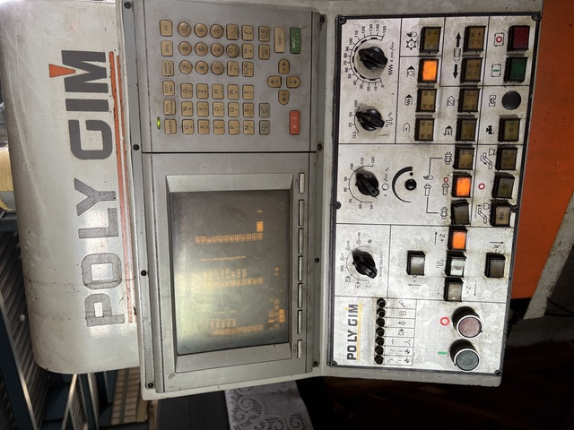

* The Polygim arrived (29. September 2026)
- the machine was deployed in a new building we need to wait for electricity now, we will continue in a few days.
* Fully implemented the Meldas Panel Keypad, a custom PCB will be made at the end of August (13. July 2026)
At this point we have the entire terminal under control, screen, Meldas button and custom buttons and switches below the Meldas terminal
* Acquired a second hand Polygim PLG-52 with a Meldas M64 controller for retrofitting (10. July 2026)

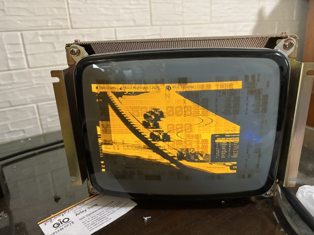

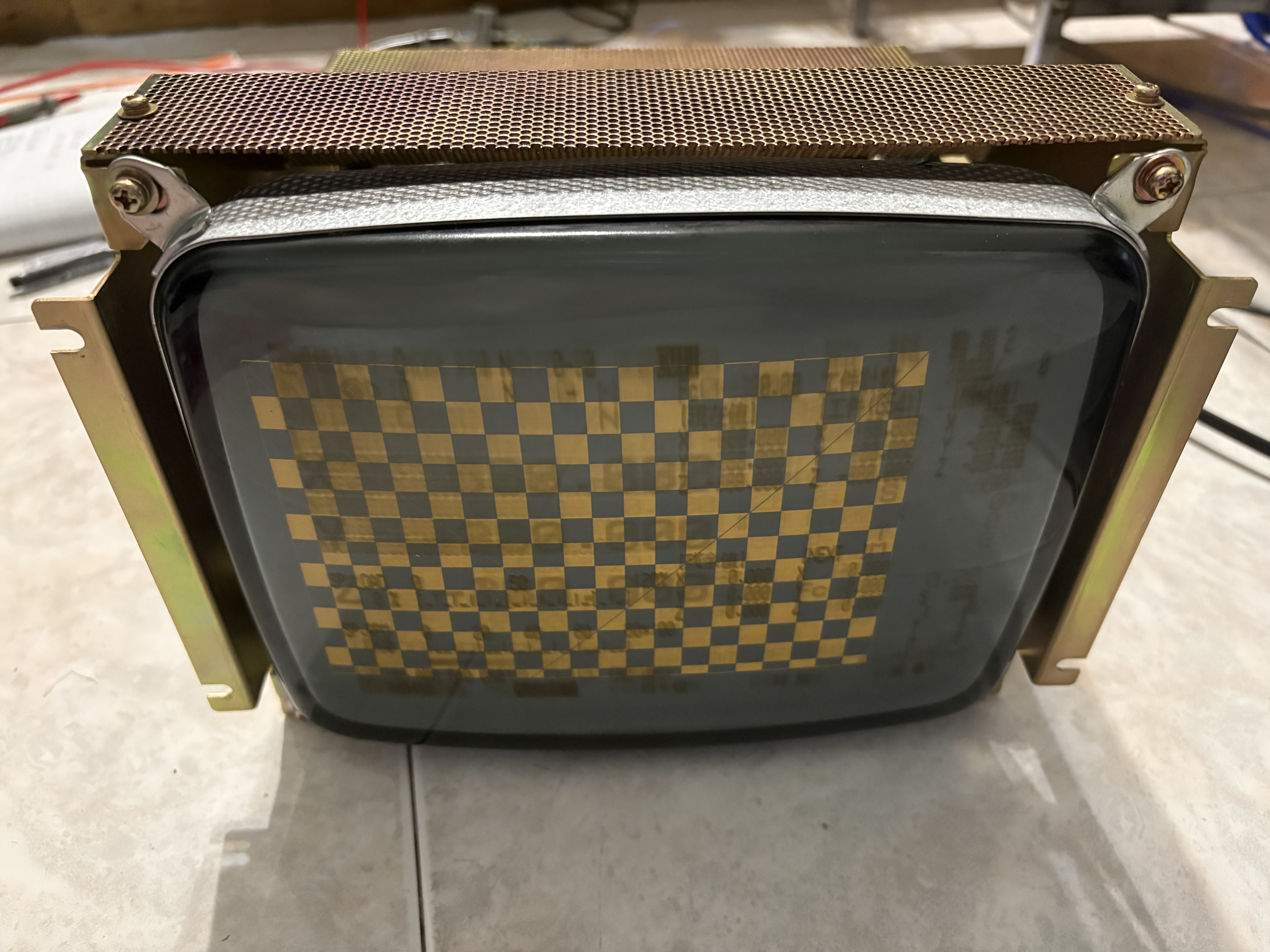

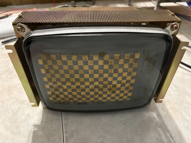

* Improved CRT support (30. June 2026)
* First test Mitsubishi FCUA-CT100 / 9 Inch Monochrome Display BM09DF, interfaced with a custom board (30. June 2026)

* For cost reduction we are working on interfacing the existing CRT monitor now (of course higher quality interfaces are possible). (26. June 2026)
The retrofit UI is a highly modern application which mimics an old terminal output.

The original Meldas M65 controller worked properly for several weeks, however the backup battery has died 3 times in a row requiring a complete setup of it again.
The motivation behind reverse engineering was to get rid of this unreliable dependency.
Imagine you turn on your CNC in the morning and Japanese kanji are showing up - you already know the machine will have a downtime of several days again.
With LinuxCNC exactly this situation will not happen anymore, neither will you have to call a Mitsubishi support person or drive to Mitsubishi to put in the options again (this requires a special cardridge in the M65 controller and can only be done by Mitsubishi or the system integrator)
All that has to be connected to our ethernet adapter - F010-CF10 -- One cable that rules it all
