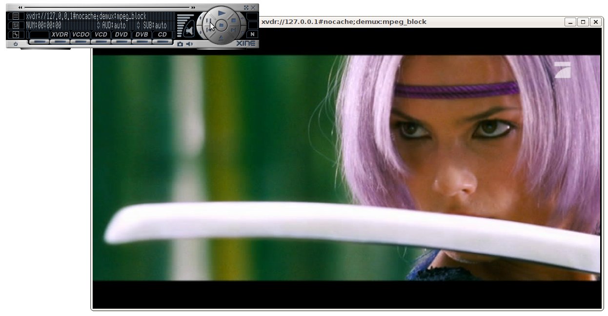

Start Xine:
 Ubuntu Menu, Applications -> Sound & Video -> Xine and finally select XVDR in the xine menu
