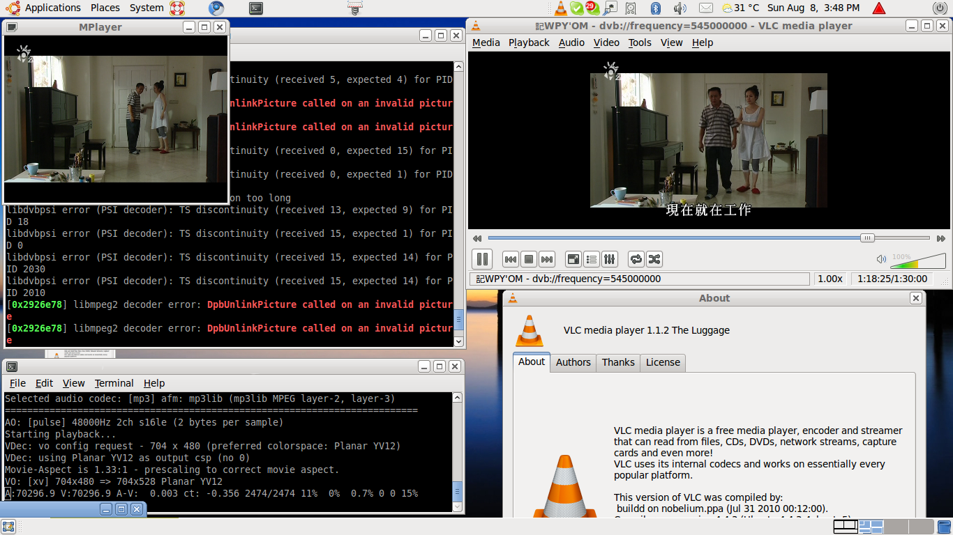

We just tested VLC and it seems to work fine, however we used the development driver which is as it says under development and will replace the 'stable' driver as soon as all new features are set.
http://www.sundtek.de/media/sundtek_installer_development.sh
you can check the version with /opt/bin/mediaclient --build
$ /opt/bin/mediaclient --build
Build date: Aug  6 2010
This driver gets updated very frequently (eg last release is just a few days ago)
Discontinuity Errors are the outcome of a too weak signal here, and only happened until I adjusted the antenna
VLC 1.1.2:
(unfortunately there are some internet connection issues the full screenshot will be uploaded when the connection is fine again).
« Letzte Änderung: August 08, 2010, 10:12:40 Vormittag von Sundtek »

I have noticed that the duration in the lower right corner, never appears in the new VLC 1.1.1/1.1.2:
even if I get the title of the channel displayed in VLC...
Could it be that the driver is not at fault, and I just have an old lib stuck, maybe the one doing the dvb decoding ??!
Well, any other suggestions are welcome, and let me know if I can provide some other logs..
Thanks,
Cheers!
EDIT: Just noticed this in mediasrv.log:
2010-08-09 09:27:52 [6467] unable to open file: ./dvb/libdrv_loopback.so
2010-08-09 09:27:52 [6467] ERROR: ./dvb/libdrv_loopback.so: ELF file data encoding not little-endian
This looks like the problem?
$ find / -name libdrv_loopback.so 2>/dev/null
/opt/bin/dvb/libdrv_loopback.so
$ readelf -h /opt/bin/dvb/libdrv_loopback.so
ELF Header:
  Magic:   7f 45 4c 46 01 02 01 00 00 00 00 00 00 00 00 00

Could this be the source of the problem?

  • Beiträge: 8743
Re:Ubuntu Lucid - VLC 1.1.1 - no video/sound for dvbt
« Antwort #5 am: August 09, 2010, 08:46:46 Nachmittag »
ok this sounds like a VLC (maybe ffmpeg) issue then and has nothing to do with the driver.
I looked at the stream and it's an MPEG-4 stream (mpeg-4 is not fully mainstream yet - so we don't wonder that there are some issues at this time since people are still working on it).
If you can capture one more sample (50-100 MB) we can host them on our server so opensource developers can download them quickly.
VLC 1.1.2 (64 Bit) works fine with this video, while mplayer does not.
In order to watch TV we advice to stick with the working VLC version for now, we'll also do some tests with 32bit VLC and put together a summary within the next days. It's mainly a video codec problem.
